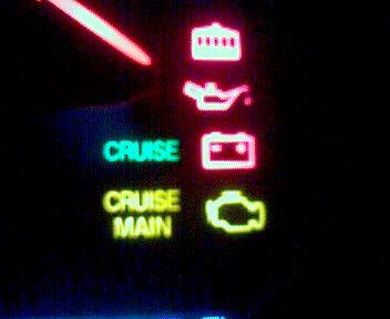

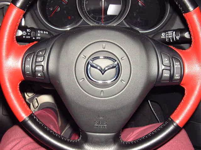

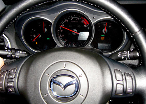

You asked for pictures? see below :oh:
RX8 talked about the price of the switch. About 150,- $ is a price I cannot believe. If it would be so, you have to add tax (your percentage) and transportation (minimum 50,- $) and customs duty. So you have to see the complete picture. And who of you has taken the risk to try out the possibility of cruise control installation and made the first experiences? I've now made some installations and documented the installation procedure.
Mazda Motors in Germany and the UK declined the introduction of a dealer installed cruise control as an option. So what's the problem?
I'm looking forward to your comments
Anze
Cruise control of a happy customer from Switzerland
my own, the first application in Europe

Your work seem to be complete and good. Thanks for pictures. Congratulation to be the first to make a Cruise control on RX8.
Thanks Againe
