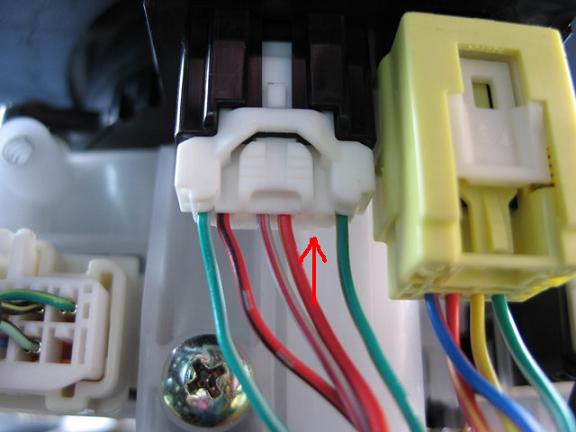

Sorry for posting in English again, but you have been so helpful... these pictures might make it easier for your members to understand what is required.
To reach the connector where the steering wheel controls are presented...
Remove the steering column cover by lowering the steering wheel to it's lowest extent, the top cover simply pops off if you apply pressure and upwards force with a thumb near the ignition barrel... and the lower has 3 screws.
Under the column cover, you will see this:-
http://www.fsck.co.uk/gallery/main.php? ... emId=12545
note the yellow connector in the upper left... don't touch it, this is the airbag connection... Look at a closeup:-
http://www.fsck.co.uk/gallery/main.php? ... emId=12548
Notice the smaller white connector to the left of the yellow one, this is the one we are interested in, so a REAL closeup:-
http://www.fsck.co.uk/gallery/main.php? ... emId=12542
You will notice 2 adjacent pins with no wires attached... these are the ones which are described earlier in this thread, and connect to the cruise control switches.

BlueAdept
Message par BlueAdept »
Thanks for the tip about the wire from the ECU being already present on RHD cars, but now I need to find where it goes!!
I have emailed the address given above regarding the cable from the ECU to the left side of the dashboard... but have no reply...
Does anyone here have any details regarding the point at which the wire from the ECU re-appears?
here are 2 free pins that you can insert,one that's coming from the PCM and the other one for the - (negativ) to the dashbord et you can use anyone you want it is the same! ;)

C'est pas tout a fait ce que demande BlueAdept, il nous indique que le fil de commande Cruise (ligne 2 colone 5) est déjà accupé. Il de mande conseil.
Je pense que ce n'est pas possible et qu'il s'est trompé dans l'identification du fil. Les PCM sont nécessairement communs pour conduite à Droite et conduite à Gauche... n'est ce pas ? A moins qu'il s'arrete après le souffelet sous le volant ??
BlueAdept, I think there are two possibility:
  • first : you haven't find good wire on CPM, chek againe please
  • last: the wire come from PCM and end near S.W. , just when wires from CPM comme on board from engin space to driver space. Please check color of wire on PCM and check it on board when all wire are.
Mon anglais étant assez catastrophique, j'aimerais avoir quelques détails supplémentaires.
Si j'ai bien compris, entre le fil rouge et le fil vert, il y a 2 connecteurs de libre et il faut brancher un fil pour le PCM et un autre fil pour la masse.
Ce que je ne comprends pas, c'est qu'on peut utiliser n'importe lequel des 2 connecteurs pour brancher le PCM ou la masse. :??: :??: :??:

BlueAdept
I have added those wires... thankyou!!...
But the PCM connector already has a wire connected (on RHD cars I am told)... so now I need to find where that leads...
http://www.fsck.co.uk/gallery/main.php? ... emId=12551
Dernière modification par BlueAdept le 25 sept. 2005, 12:39 PM, modifié 1 fois.
oh yes I've now understand your prob. but I have no answer :( I never saw it in original bevor :( :??:
:oups:
but if you can knew the color it has (look on the PCM) and search it under the dash??? :??:
BlueAdept
It is a RHD car, but the wire goes to the Left side!!!
There are many wires that colour behind there!... :oups:
Ai-je bien compris?
Ce serait inhabituel. Mais dans la mesure où le système fonctionne avec des résistances en série, ce n'est pas impossible...
