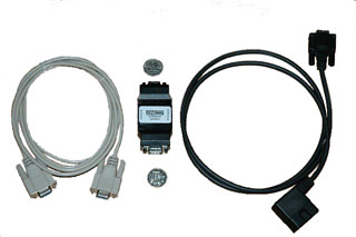

Contenu :
Hardware : 1 x OBDII cable
1 x Diagnostic Interface
1 x serial cable.
Software :
sCANalyser Live 1.0 (what you have in the beta, plus bug fixes) (On CD)
Plus sCANalyser Live 1.1 Beta (On CD)

    Shipping with the software will be a serial interface, cable to connect interface to the OBD socket as well as a 9 pin serial cable to connect the PC to the interface. The OBD cable has a right angle plug which minimizes the intrusion of the plug in the the footspace.
