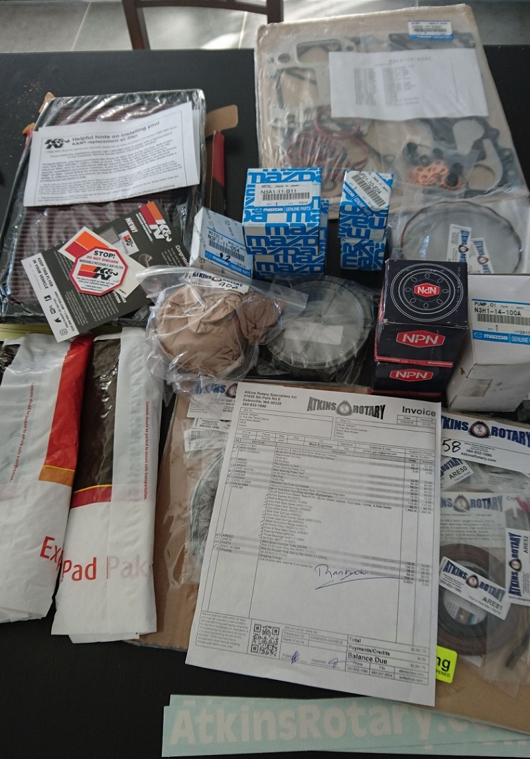

Item list
93-11 Rx7 & Manual Rx8 Rotor Bearing (N3A1-11-B11)
93-11 Rx7 & Manual Rx8 Stationary Bearing (NF01-10-E04)
Rx7 & Rx8 Oil Filter
74-11 Rx7 & Rx8 Pilot Bearing & Seal (ARE82)
Rotor Bearing Tool (ARE-Tool-Bearing-Rotor)
Main Gear Bearing Tool (ARE-Tool-Bearing-Main)
04-08 Rx8 Clutch Release Bearing (FE62-16-510)
Thin File
Thick File
Competition Adjustable Oil Pressure Regulator (4352-14-250)
04-11 Rx8 K&N High-Flow Air Filter Replacement (33-2284)
04-11 Rx8 Manual Master Rebuild Kit
• Hylomar: Include It /
• Water Jacket Seal Type: Atkins Brown Water Jackets /
• Apex Seals: Cryo Atkins Apex Seals /
• Corner Seals: Cryo Solid Corner Seals /
• Side Seals: Cryo Side Seals /
• Cut Off Seals: Include (ARE76) /
• Cut Off Seal Springs: Include (ARE75)
04-08 Rx8 Oil Pump (N3H1-14-100)
Le calorstat sera acheté ailleurs. :merci:
Sinon bonne nouvelle, 48€ de douane seulement. :ok:
