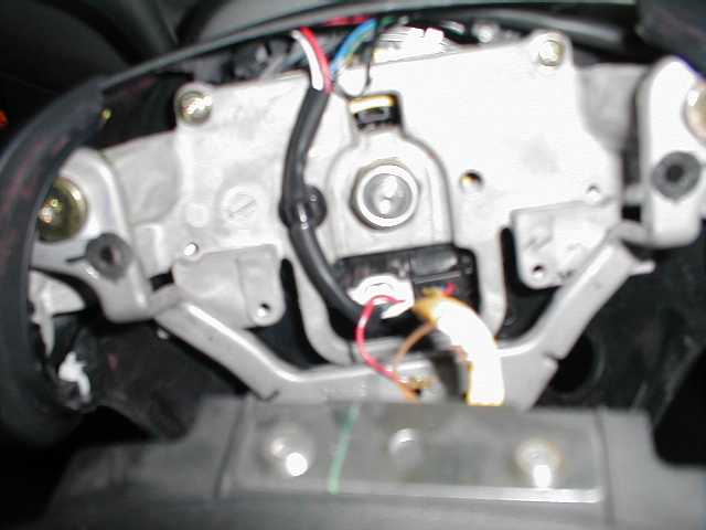

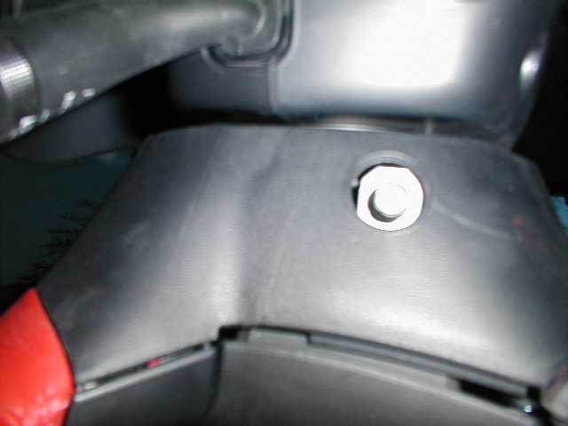

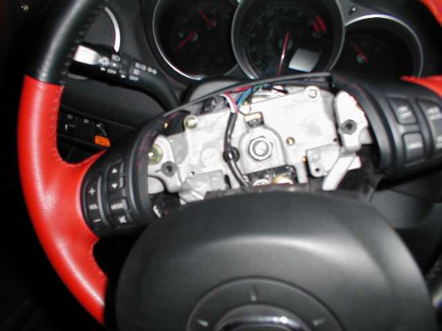

Voici les boulons pour démonter l'air bag du volant.
Désolé pour la qualité :grr:
RX8
Messages : 1628

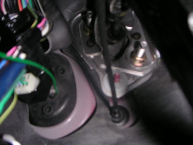

Message par RX8 »
Vous pouvez voir le passage de cable qui part sous le volant de chaque coté, pour les deux "panel buttons"

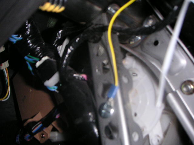

Message par RX8 »

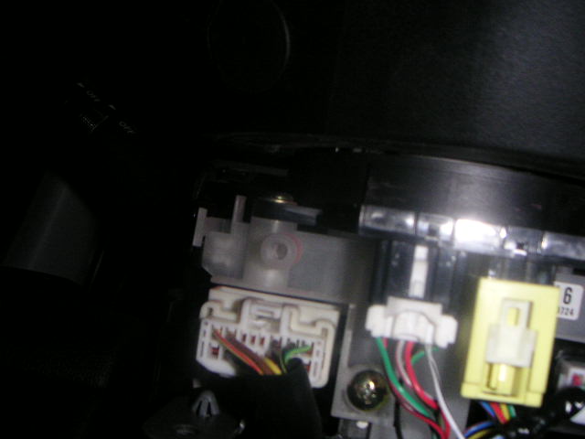

Ici on voit bien le fameux fil rouge de la masse qu'il faut récupéré pour insérer dans le nouveau connecteur.

The new switches are Mazda part number F157-66-4MOA
BlueAdept
Message par BlueAdept »
My pictures are at:-
http://www.fsck.co.uk/gallery/CruiseControl?page=1
Note that you CAN take the plug apart without destroying it!!.. :yeah:

Yes, that part includes both sets of switches... but thank "RX8" as he did it first, and figured out the trick to rotate the rear cover so you don't have to remove the wheel...
I don't know if local dealer can order that part, because I tracked it down through Mazda dealer in Australia, they shipped it from there.

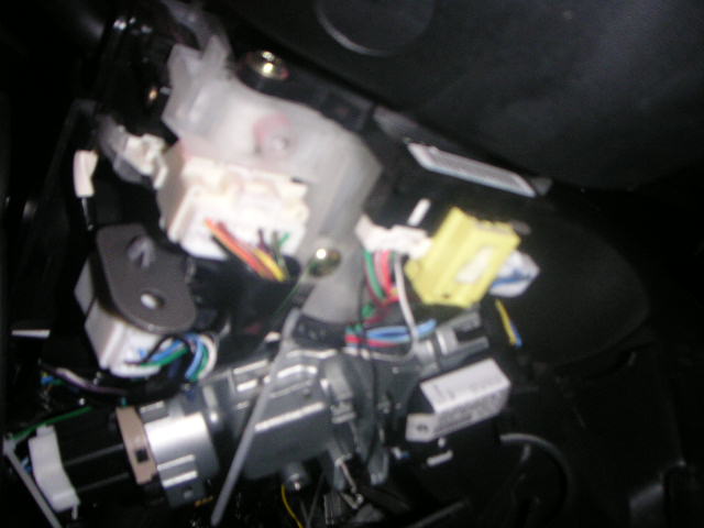

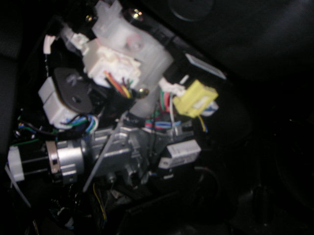

ci joint qques photos de mon montage.
On the middle white connector you could find from right to left
  • green wire (original)
  • white wire : new signal wire it continue after in green
  • black wire : new ground , it continue in yelow
  • red wire (original one)
  • green and red (original one)
  • no cable
  • black and red (original one)
  • green (original one)
Dernière modification par RX8 le 17 mars 2005, 22:33 PM, modifié 1 fois.

Message par RX8 »
suite
BlueAdept
Great, that's clear enough...
Use the "Macro" function on your camera to get clearer photos BTW....
RX8
Messages : 1628
Message par RX8 »
Sory for pictures :( . Thew was done on my garage and it's very difficult to do it with a very little light. It's not a focus problem :non: , the Auto Focus is very bad if the light is too low.
