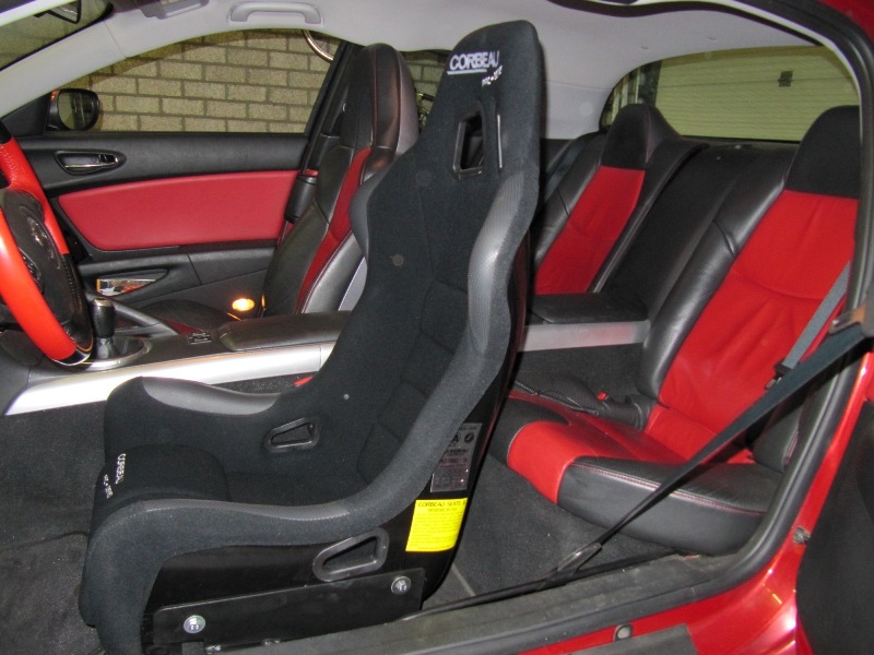

My racingseat is mounted.
Still got a small problem.
Because the airbag in the seat is no longer there, the airbag warning light blinks.
Does someone know how to fix that??

Do you still fit in the seat with the helmet ... seems high ?!

Nice Corbeau seat ! :clap:
For your problem, go here :
http://www.rx8france.com/forum/ftopic6103-0-asc-222.php
You need to use a 2.2 ohm resistor on the yellow connector !

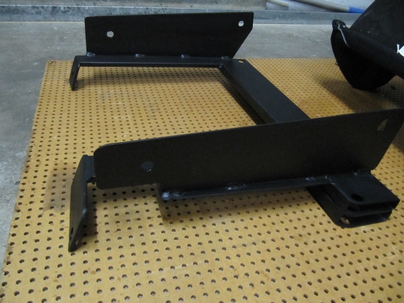

@Baphi:
The seat is mounted as low as posible and is mounted totaly fixed by a selfmade bracket.
It is about 4 cm lower as as the lowest position of the original seat.
Now I can use a proper helmet instead of the very thin one without any aproval.
On the pic the self made bracket.

So you mean I have to link the 2 wires of the yellow connector with a 2,2 ohm resistor?

Yes, it's a dummy "airbag system" for the PCM.

Thanks!
I only have to take out the seat again to reach the connector, but that is OK
Here the site from the corbeau reseller:
I payed 500 euro (Instead 515 plus tax) because it was used for one day:
It is made from Kevlar.
http://dutchraceandrallyparts.nl/product.php?id=50
