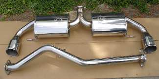

cosmos
Messages : 818
Localisation : Lausanne
Message par cosmos »
Je l'ai commandé ici. Il faut ajouter $160 USD pour le transport + la TVA. (il coûte $699 USD chez http://www.greddy.com)
"Greddy SP 2 Exhaust System. NOW IN FULL STAINLESS STEEL ! It wasn’t easy to improve on the popular GReddy SP system. But through customer feedback from over 10 years of use and testing, GReddy redesigned the SP as a full stainless steel cat-back exhaust system that is similarly priced to the original SP system. The new SP2 features a 304 stainless steel muffler canister with extra strong 430 SS end caps that feature a deep, high polish. Large, high volume mufflers provide maximum flow with a deep, pleasing tone and are especially effective when used on vehicles with aftermarket turbocharger systems. The unique outer curled oval tip (115 x 110mm dia.) is embossed with the famous GReddy logo. Employing state-of-the-art robotic seam welding, the single wall canisters feature increased rigidity for maximum durability and life. With over 35 types of internal perforated tubes, each SP2 application is specifically tuned for the best combination of sound and performance. The new SP2 also features thick walled (1.5mm), polished 304 stainless steel mandrel bent piping for better resonance and vibration control and enhanced corrosion resistance and durability. New lightweight, flared and stamped stainless steel flanges are also used to provide improved sealing characteristics. The GReddy SP2 Exhaust System will initially be available for over 50 popular Japanese vehicles with more to come as they are developed."
Il est livré avec un intermédiaire.
Invité
Message par Invité »
Il est superbe :love:
